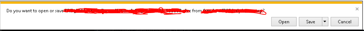

    Moreover i've a problem to interact with this i.e. bar​
    I've tried to put in Navigate stage "Activate application" in win32 mode, then GSK "%(N)", "{TAB}", "{UP}", "{DOWN}", "{ENTER}" but it ends to url bar.
    Alternatively i've tried UIA & AA Mode but i'm not able to do the second click on "SAVE AS..".

    Hi Vrat,
    I know that tool bar well!
    You may have different options available to me as the later versions of surface automation (6.3 onwards I believe) should handle this well.
    But I spied the down arrow button next to save (I think in AA), then used GSK directly to the button to press down and then enter. This resulted in the document being opened and saved. You can use the same environment action to check when it's finished opening, also a good idea to read the document name from the tool bar for an input (some calcs will be needed to chop it up).
    This is from memory and unfortunately I don't access to it anymore, so some details may be a little off.
    Let me know how it goes.

    Posted 01-22-2021 03:35
    Thanks @Ben Lyons,
    the proposed solution works!!! :)
