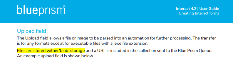

    i m trying to understand where the uploaded files by form interact request are saved.
    Specifically, i looked for into db about a table that could contain some information about the file, but without success.
    The only useful information is the URL that communicate Blue Prism into the collection after the file is correctly uploaded.
    Into the BluePrsim's guide, the only reference i found about it is:
    So, where the uploaded file are saved specifically?

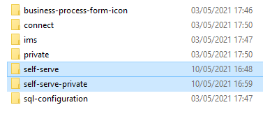

    Hi Ambrogio
    The file isn't stored in a database, it is stored within the hub web server. As a default, the path for this folder is "https://file.local/Files/self-serve-private/". The uploaded file is also assigned a GUID as part of the Upload File VBO to ensure that files uploaded with the same name are unique.
    For example, here I have uploaded a file called "image.png" and the link received from the VBO is "https://file.local/Files/self-serve-private/image.ad21bb40-82f4-4fdc-99ab-d7e07fd080cb.png".

    If possible, i have another question:
    i noticed that the uploaded files from Interact Web Form are saved into <path>Files/self-serve/ and can be downloaded by put them link address into search bar of browser. (example: https://file.local/Files/self-serve/image.ad21bb40-82f4-4fdc-99ab-d7e07fd080cb.png)
    If i used the method "Upload File" into the object "Utility - Interact API" , the file is saved into the folder <path>/Files/self-serve-private/ and using the link into the browser search bar, it s not possible download the file (with HTTP ERROR 401).
    It's possible use the method to upload the file into the not private folder, so as to reachable to download by search bar browser?
    Exists a way to download the file used the link address (the output of "Upload File")?

    Hi Ambrogio
    It's not possible to download the file using the link address in that way, It can only be accessed through Interact.
