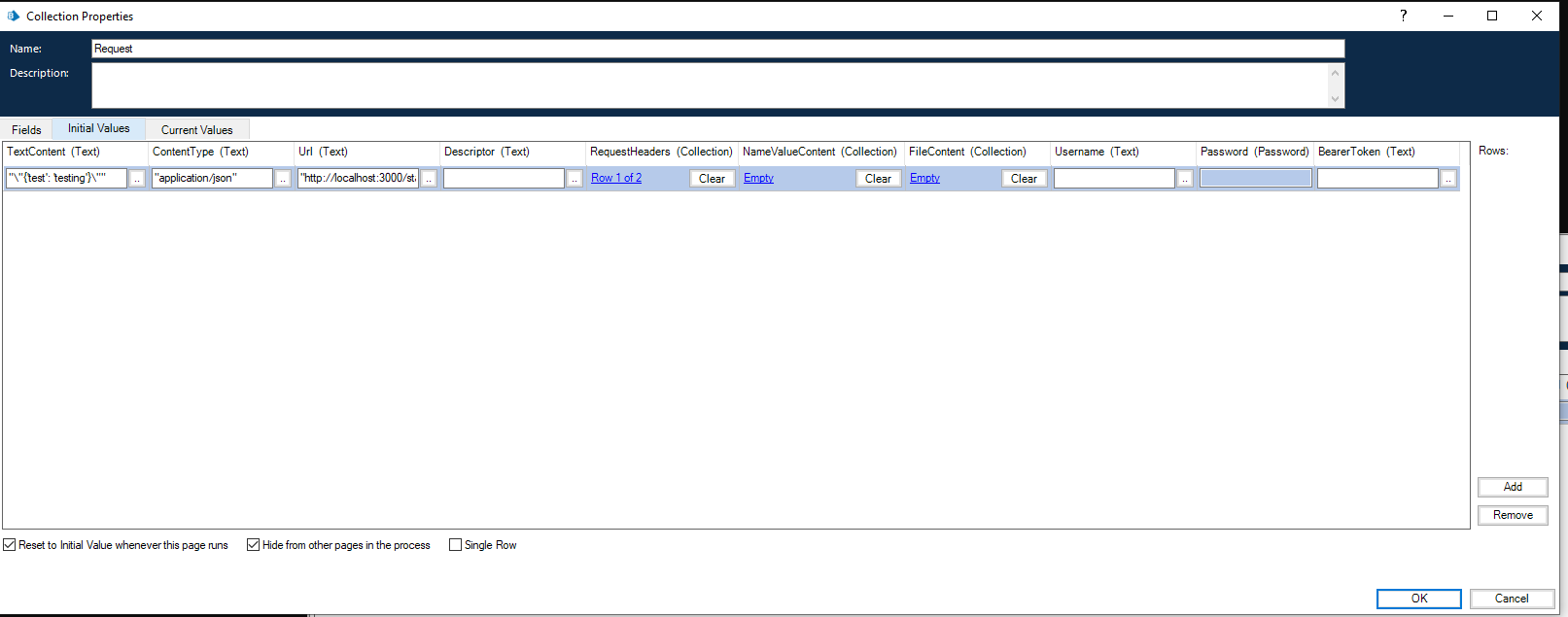

    I'm trying to POST a simple JSON object , but I keep getting an error. Also I'm calling the startup action before POST.
    See the end of this message for details on invoking

    I created a request collection to match the docs. If I leave out a field regardless of it saying it's optional, then I get an error in regards to that field so I have fields that are there, but not populated too. (optional ones). Also the docs say JSON needs to be a string so I assume you have to stringify it, but I tried that and just wrapping JSON object in quotes like this
    "\"{'test': 'testing'}\""
    AND
    "{'test': 'testing'}"
    but that doesn't seem to work unless something else is causing my POST issue.
    Here's my request collection
    What am I doing wrong? I appreciate any help!
  • 2.  RE: Utility - HTTP (Async)::POST JSON issues
    Posted 4 days ago
    @Jason Cappleman,
    Have you taken a look at the example performance measurement process included on the asset page for the async HTTP VBO?
    If you're sending just regular JSON you'd want the TextContent field of the record to look something like this:
    Do not place double quotes around the value. This is just like a Text data item. Also, your ContentType entry should just be application/json. Do not include double quotes around the value. Text data items, in Blue Prism, are not double quoted. Double quotes are only necessary when you're dealing for a Calculation stage/field value.
