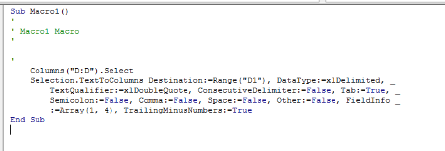

    I wanted to convert text or custom columns to date columns using a code stage. But when i declare the array as you mentioned above its not working. Its throwing an error
    I have recorded the manual operation using record macro. PFB
    Could you please help me in declaring the array for the above code in such a way that i can use it in my code stage!!!!!!

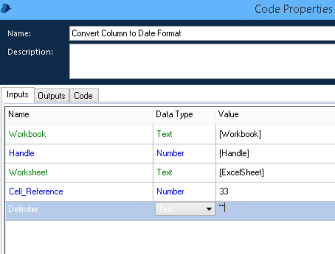

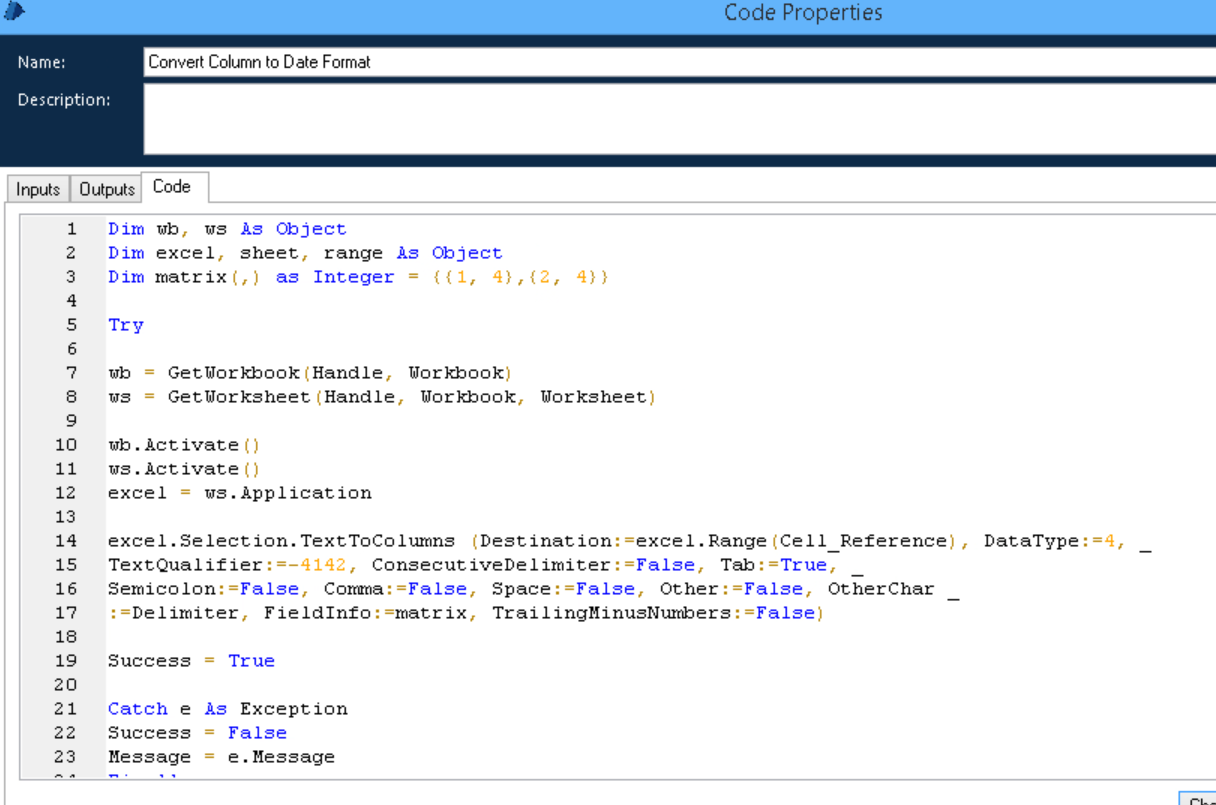

    I am trying to use this code to convert  AG column (33th column from an Excel file with mutiple columns) into a DATE format column but I think I am doing something wrong because I get the "The given key was not present in the dictionary" error.
    Maybe the input is not ok? Can you please help me ?
    Thank you,
    Irina

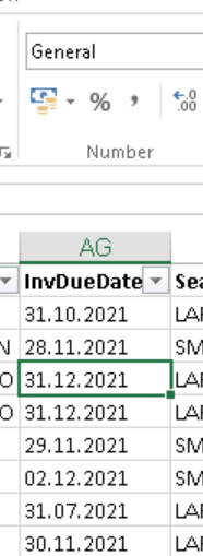

    Thank you so much for your response! I resolved the "The given key was not present in the dictionary" error, now the message is "Success", but not working as expected.
    I need to make AG column (column number 33) from 'General' to 'Date' (DMY option) and I am using this code below, but nothings happens, although I do not receive any error. I also tried with DataType 4, and TextQualifier 1, but nothing changes.
