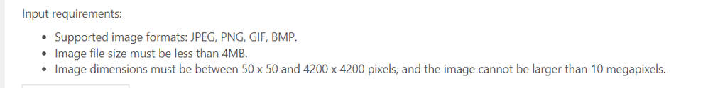

FYI - There's also a note on the API reference page for the Read action that if you're using the Azure Free Tier, they will only process the first 2 pages.

So you're passing in images you created of the 4 page PDF (4 images), correct? What image format are you using?
Here's an excerpt from the Azure Vision reference that describes image requirements:
Do all 4 of the images meet the above requirements?
