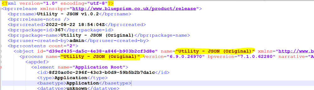

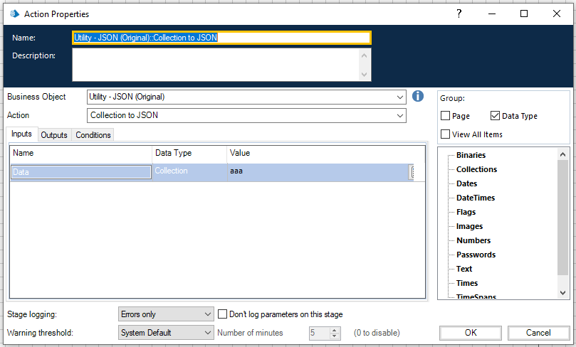

I try to make a simple example with the "Utility - JSON", Save As with the name "Utility - Json (Original)" and I make a process that call one of the internal actions
Then, download the new VBO version from the DX store, and edit it with a Notepad. (I use Notepadd++, but the result is the same, just edit it)
As you can see in the image bellow, the object name is indicated in this text.

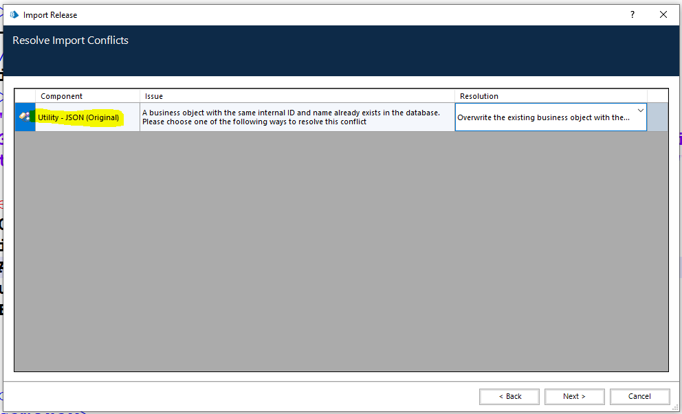

I replace the original name with the new custome name and import the new edited file

I've come up with a crazy idea to solve this.
But first to all, I am not responsible if anything else breaks, do this with care.
And another recomendation, I think, the best way is to rename the altered VBO, not the original. But, whatever:

@PabloSarabia Thanks for the reply.
But if we edit XML and import the object it will overwrite the actual object with the new name.
For example in your case if you have "Utility - JSON" AND "Utility - Json (Original)" both in your blue prism database and you want to import new version with the "Utility - Json (Original)" name then if you follow XML editing option then your "Utility - JSON" object will replace with the new object and name will change to "Utility - Json (Original)" because the process id is same for the Utility - JSON and new incoming object.
So we cannot follow this way, if we want then we should know the Object id for "Utility - Json (Original)" from DB and change into XML.
The deleting object and import with the same name will work , but i want to confirm if any Object Id is referencing in any where or not.
