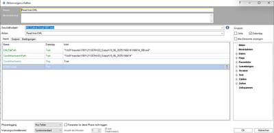

tim.dauti
Hi @GeoffHirst ,
here the screenshot:,
Kindly
Tim Dauti

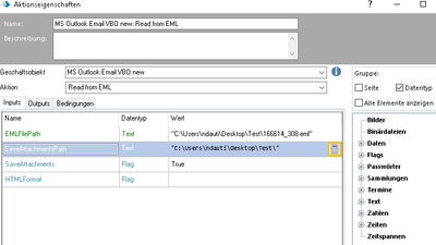

GeoffHirst
Hi @tim.dauti
The SaveAttachmentsPath, could you add a '\' (backslash) to the end and retry, please?
thanks
Geoff Hirst Senior DX Engineer - Digital Exchange - EMEA SS&C Blue Prism
Hi @GeoffHirst,
I tried both with and without backslash but does not change.
Kindly
Tim Dauti
GeoffHirst
Hi @tim.dauti ,
I think the problem must be the fact that you are using a server path, rather than an actual file path. This would require some re-engineering of the asset to support this. It was never tested against server paths when it was created.
If you are able to map those paths to drive letters, and retry?, that would confirm this.
regards
Hi @GeoffHirst ;
I tried that as well, but it does not work
