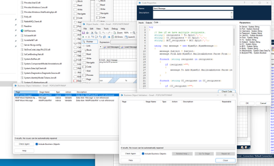

GeoffHirst
Hi @mforgach
I have managed to overcome my administrator issue. Here is a screenshot of what I see in relation to Send Message.
I do not see the error you do. Which can only mean there is something different between your version of 7.3.0 and my version 7.3.1. Would you be able to try 7.3.1 in isolation somewhere, and see if that is the issue? Did the previous version of the asset, 10.4.3, work for you? If so, the only real difference between the 2 versions was a slight change to the SSL checking code, which in 10.4.4 was made simpler.
Let me know your thoughts and if necessary, I can either let you have the previous code for the send message button or you may be able to retrieve it yourself using the previous versions of the asset list.
regards
Geoff Hirst Senior DX Engineer - Digital Exchange - EMEA SS&C Blue Prism
