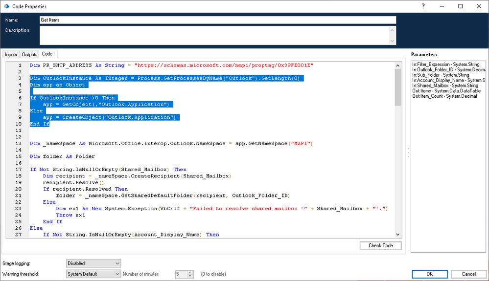

Since you said it's specifically when Outlook is running, it sounds like something's preventing multiple instances. Try making the following modifications:
Code Options -> External References:
-Add: System.Diagnostics.Process.dll
Code Options -> Namespace Imports:
Internal_GetItems code stage:
-Replace the line for "Dim app = CreateObject("Outlook.Application")" with the following code (Screenshot of implementation also attached)
Dim OutlookInstance As Integer = Process.GetProcessesByName("Outlook").GetLength(0)
Dim app as Object
If OutlookInstance >0 Then
	app = GetObject(,"Outlook.Application")
Else
End If​
