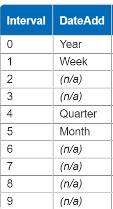

Plz explain difference between Interval 8 Days of Year & Interval 9 Days

Hi Swapnil.
I have replied to the other thread where you asked this question for DateDiff. However, for DateAdd these intervals are not valid as it only accepts few selected intervals as shown below:
WonderBotz India Pvt. Ltd.
