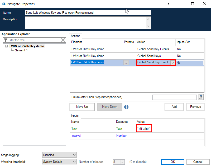

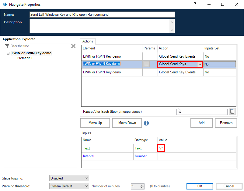

not sure if you were able to figure out how to send the combination of Windows key + R to open the Run window, but in case you haven't, and for future reference, this can be achieved by doing the following in your Navigate stage:
1. Use a "Global Send Key Events" to send the Windows Key using the text value "<{LWin}"
(Note: 'LWIN' is case sensitive)
2. Use a "Global Send Keys" to send the 'r' key using the text value "r"
3. Use a "Global Send Key Events" to release the Windows Keys using the text value ">{LWin}"
Further technical details on how Windows treats Send Key Events can be found in the following link:
