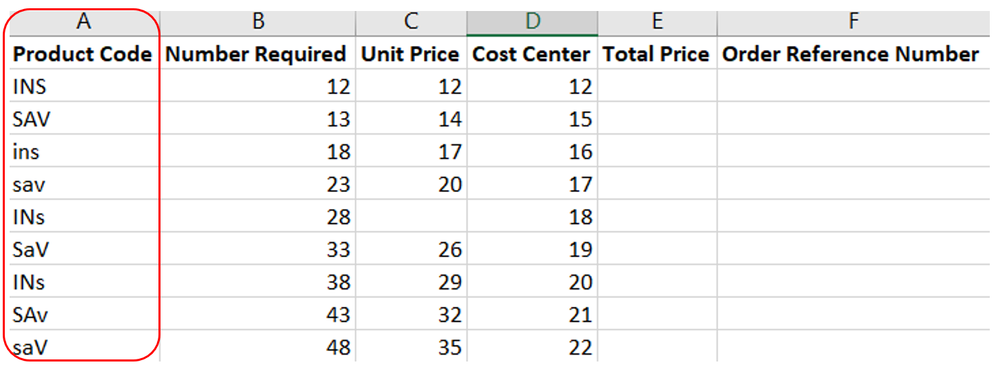

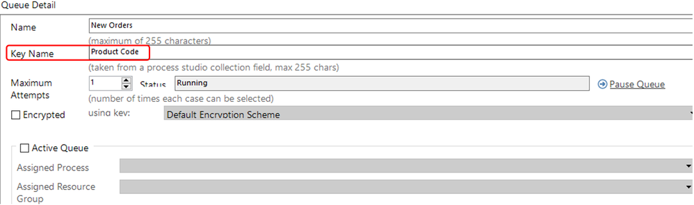

Coming to your first question, the parameter which you can set to uniquely identify the item while adding to the queue and can also use as a parameter in the inputs of the action 'Is Item In Queue' is called as 'Item Key' which may or may not be unique in nature as you are the one defining it, so it depends on your business scenario altogether. Whereas, coming to GUID, it is randomly being generated by Blue Prism every time any item gets added to the work queue. This GUID is also called as 'Item ID' which is returned as an output from the 'Is Item In Queue' action.
Example:
To showcase an example, I took an excel data source where I have set the 'Product Code' column as the 'Key Name' value in the queue settings of my Blue Prism:

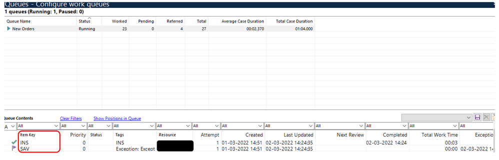

Now once the items have been added to the queue, from your Queue Management window, you can see the Item Key that you have used for adding an item as highlighted in red below. However, you can never see the Item ID or GUID from here:
Now if we have a look at the backend database in Blue Prism to check the same. You can see that the column highlighted in red is the Item ID or GUID associated with the item that got randomly generated while the column highlighted in green is the key value column which is set by us while adding the queue items:
So, here you can see that although 'Product Code' is my Item Key, it necessarily is not unique as it totally depends on the data I am providing to Blue Prism work queue. For example, if it were a list of service now incident tickets it might have been unique so it depends on the business data. However, the GUID or the item ID is always going to be unique no matter what as Blue Prism handles that internally.
Example:
