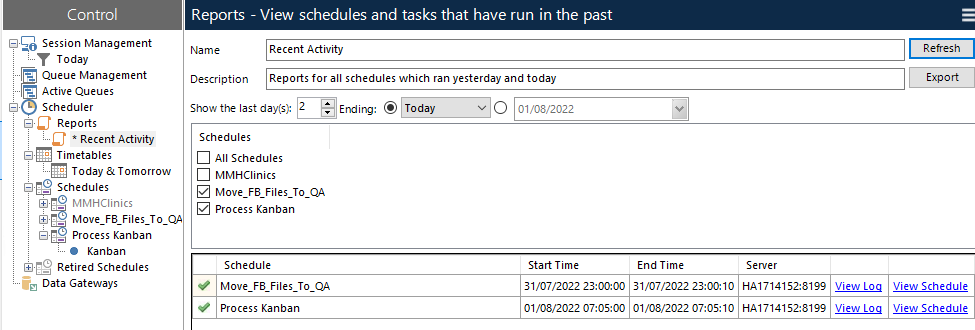

This is the schedule. 'Move Files to LSAPPQA' runs and fires correctly. The other two (MMH clinics and kanban) show they ran but they did not
This runs
This does not
But shows it ran
I can see any difference between this process and the one that runs ok - they do different things but as I mentioned if I run them manually they work fine.

- License is supplied by my organization and so I wouldn't have thought it was to do with that. Even so it is running one of the processes I created  - if I schedule 'Move_FB_Files_To_QA' it runs at the scheduled time and works fine. But if I un-schedule that and schedule one of the other processes (so theres only one process scheduled and set to run), it shows it ran but didn't
 - I dont believe so. I created a business object and process in the same way I did for the one that does run. I created the one that runs ok a few months ago and these two new ones just the other day but I don't believe I have done anything differently.
As for the schedule logs
The 'move_fb_file_to_qa' ran last night as 11pm - worked fine

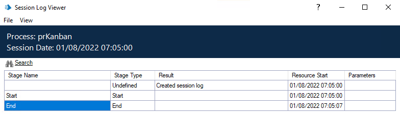

The log for 'process kanban' just displays this
