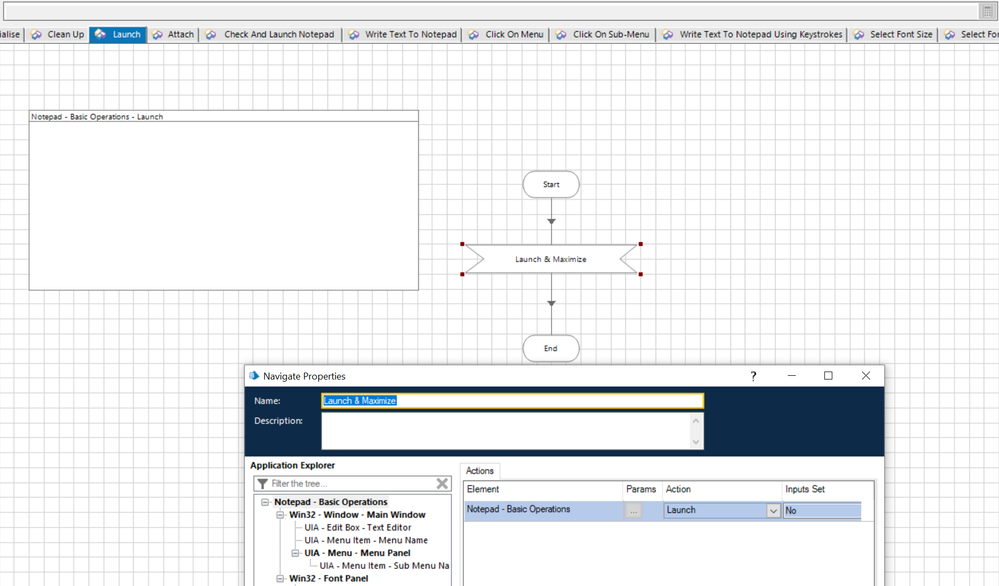

In order to check the attach status for any application you can use a 'Read' stage with the root element of the application tree and the action as 'Is Connected' which will store the status as True or False in any data item you specify, then you can proceed ahead and check the status. If the status is True, end the action otherwise try to attach the application using a 'Navigate' stage as shown below:
In my case I have used two page references for attaching and launching the application which consist of the respective 'Navigate' stages only.

Just one query, how to check for the attach status in the 'check connection status' ? How to get the Yes/No condition while checking the connection status ? I have just started learning hence getting stuck in these things.
Manjit Singh
Hi Manjit,
Please refer the first screenshot, I have show there that I used a read stage and then in that read stage I used the element as the root application node with the action as 'Is Connected' and have stored the value in a data item called 'Is Connected'. That stage will itself return me the value as True or False for the attach status which I am checking in the decision stage with the expression : "[Is Connected] = True". For more details on this, I would advise you to go through the following LMS as well: Business Object Design
