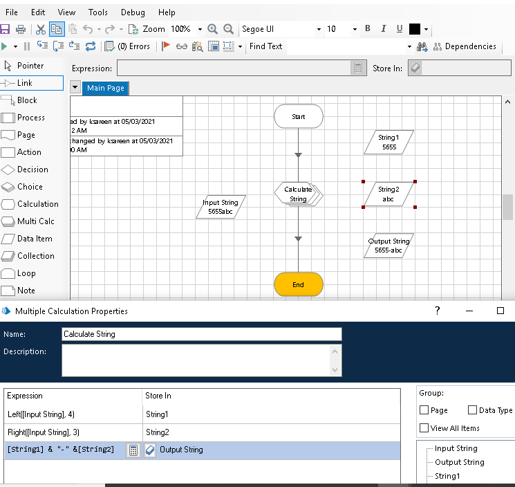

I would like your help to do the following please... and thank you in advance for your help and time
Basically, I have data item 5655abc, and with the calculation stage I am trying to have the dash level sign (-) added
to provide the following result 5655-abc, but I am having problem... can you please help?
Thank you once again

You should be able to get the output by using the steps in the attached image:
I hope you'll find this helpful. Let me know if you have any doubts

19-03-25 07:16 AM
The below solution may help you by storing the data in a data item called "Data", and if the data is changing but with same number of digits and alphabets.
use calculation stage and perform this:
Left([Data], 4) & "-" & Right([Data], 3)
