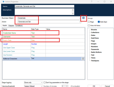

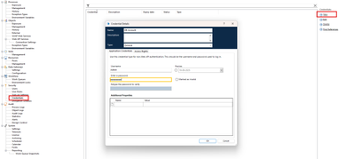

Instead of using Environment variable you can use Blueprism Credentials Vault as it is more secure and the password can be updated using the Credentials VBO.
https://docs.blueprism.com/en-US/bundle/blue-prism-enterprise-6-7/page/helpCredentials.htm
You can also click on "i" symbol to open documentation about Credentials VBO to get details steps about the mentioned action.

I would suggest to get the credential stored in Credential Manager rather than Environment Vairable though. 🙂

Always use credential manager to store the credentials that would be the best practice in RPA. Kindly avoid using EV's to store the Credentials. & Please check the permissions to access the BP to avoid this type of issues.
