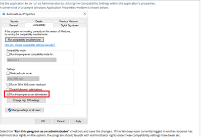

Hi @rabbanir
Assuming that you have  updated the properties in blue Prism  as mentioned in the screenshot but still unable to  run from control room.
https://support.blueprism.com/en/support/solutions/articles/7000078521-bpe-error-similar-to-internal-failed-to-perform-step-1-in-navigate-stage-launch-on-page-launch-?_gl=1*ykhl78*_gcl_au*MTgyMTMwOTU3....
Harish Mogulluri
