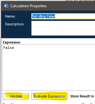

In this type of scenario, it is always recommended to check expression using these 2 buttons in the expression editor.
