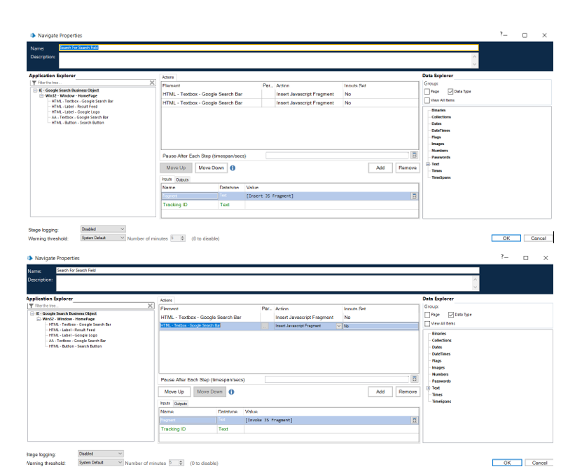

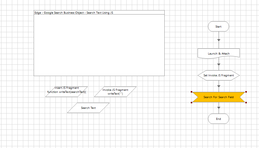

'Invoke Javascript' action doesn't work strangely at all times. But a way that I always have used Javascript in my project is by using two 'Insert Javascript' actions where the first action inserts a function definition altogether and the next 'Insert Javascript' action will call that function. Below is an example of how I use it:

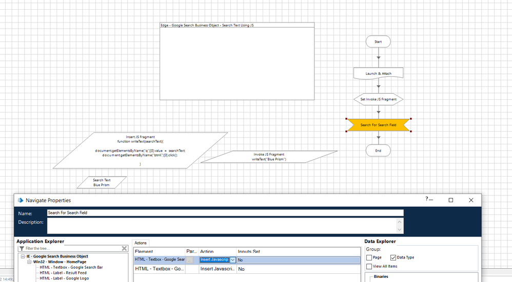

Going inside this business object now, you can see I have two data items created called, Insert JS Fragment and Invoke JS Fragment.
The Insert JS Fragment has a function definition mentioned which looks for an HTML element with the name attribute as "q" which is the search textbox in google and then writes the value which I am passing through it. Once the value has been written, the code looks for the name attribute as "btnK" which is the search button.
The function is as follows:
function writeText(searchText){
                    document.getElementsByName("q")[0].value = searchText;
                    document.getElementsByName("btnK")[0].click();
The Invoke JS Fragment is calling that function while passing the value as well which in my case is : writeText("Blue Prism")
Now in order to execute both these functions one by one I have used one Navigate Stage and have used the action "Insert Javascript Fragment" twice. The first time I am inserting the "Insert JS Fragment" data item and the next time I and again using the same action for inserting the "Invoke JS Fragment" data item.
In your case also the actions will be similar, the only thing that will change is the JavaScript code where you can use getElementById if you have the ID attribute for which you just need to use the click() function and not write anything. Also, no input parameter would be required to be sent out so your Invoke JS Fragment data item would also be something simple like: function_name()  which in my case was writeText("Blue Prism")
