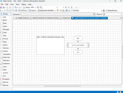

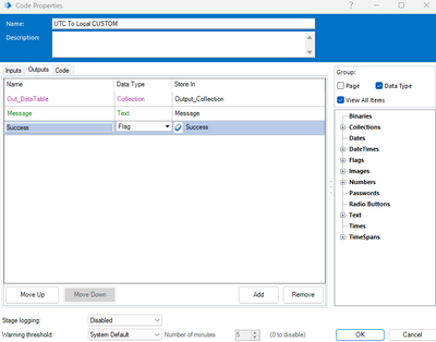

Go to colection manipulation add a new action name it [Apply Function UTC To Local on column - CUSTOM], then drag and drop a code stage and name it UTC To Local CUSTOM and publish it like this :

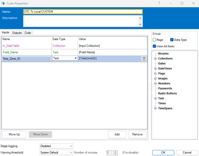

Open the code stage and provide these for input :

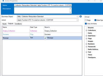

Do the same for output
In Code stage put this :

Like this :

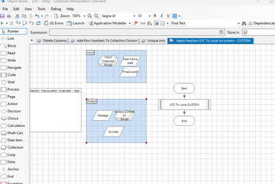

Your action should look like this :
Dont forget to put the inputs in start stage and the output in end stage.

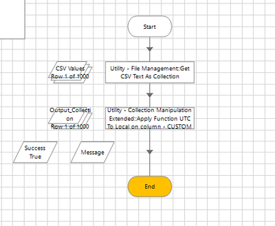

Lets make a test.

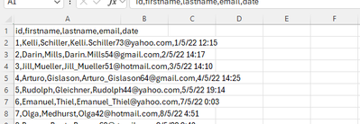

I have these csv file see below :

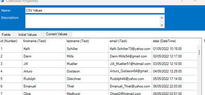

When i import it inside Blue Prism i have this :
Notice Blue Prism make the conversion to UTC by default.
Now i want to use my CUSTOM CODE, see below the parameters :
Notice that i leave the timezone empty because its already set by Blue Prism but you can provide
some of these inputs for timezone id :
"Eastern Standard Time" , "Central Standard Time" , "Mountain Standard Time" , "Pacific Standard Time" , "Alaskan Standard Time" , "Hawaiian Standard Time", Central Europe Standard Time", "India Standard Time" and there is more 🙂
Try to leave it blank at the begining and if its not working for you try to put your time zone id.
Your process should look like this :
Now run and you will have the same wanted value see below :

Like this :

Lets make a test.

DipinDevP
Level 6
@Mohamad_Dakkouri It worked for me!
Thank you very much!
