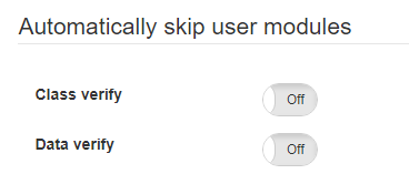

If you're happy with your document training and ready for enabling auto-verification, you can take the following steps:
1. Go the admin panel
2. The click on Configuration under the System heading
3. Switch on the auto-skip for the respective modules
This will be enabled for all batches, so be mindful that this will also affect documents till being trained. The way to manage that is to ensure you have added the "Required" flag to all essential fields.
If they are still being held up, please get in touch.

Hi Ben,
Thankyou for your response.
I have applied the settings you suggested.
From what I understand, once auto-verification is enabled, Decipher will not got to Manual Verification stage once it reads all the fields that are marked as Required. Please let me know if my understanding is correct.
