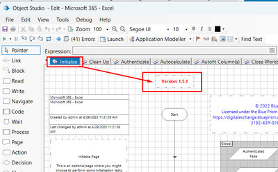

Can you let us know the version of the VBO that you are using?
Have you tried using a new version of the VBO?
Here is an example of how to look for the VBO version.
Neel1
Hello @expertcr  - I am using the latest 1.5.1 version . i mentioned the link in my post.
