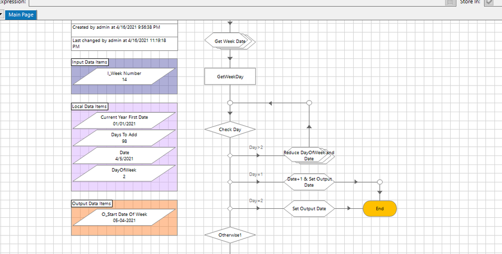

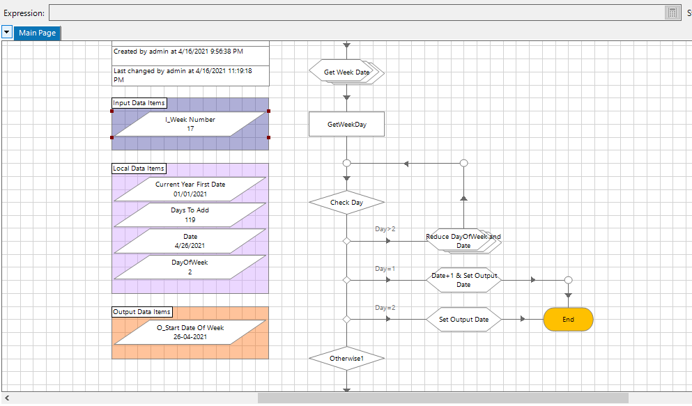

Hi Krishna,
Please also find the native Blue Prism "No Code" solution for this problem.
Only dependency --> Utility-Date and Time Manipulation (Get it from DX simply)
XML file attached. Hope it helps.

P.S. Attaching XML since unable to upload .bpprocess extension file.
Thanks & Regards,
Tejaskumar Darji
Hi Tejaskumar,
I'm intrigued to try that solution. But I have a couple of questions.
  1. Would it support previous years or only the current year? I imagine Krishna may only need it to work for the current year, but it'd be cool if it worked for previous years as well. Part of the reason I grabbed custom C# code is that it was designed specifically to handle difficult years.
  2. My Utility - Date and Time Manipulation VBO doesn't have an action called 'GetWeekDay', and I'm using 6.10.1. Are you sure that isn't a custom action that your organization added? In any case, I would think it's simple code, but I'm not sure what output it's going for. The Utility - Date and Time Manipulation VBO on the DX also doesn't have that action.

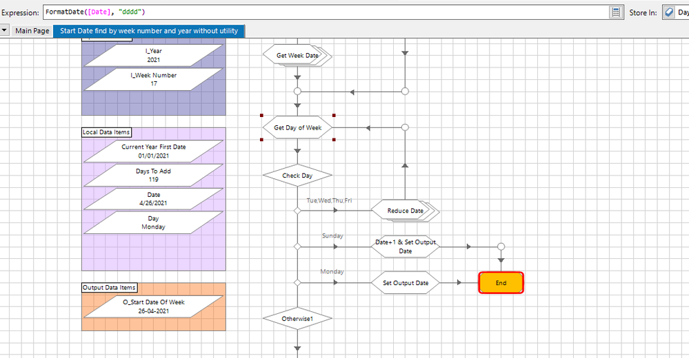

Hello Dave and Krishna,
Thank you Dave for providing valuable suggestions on 1. To extend the logic to get input year as well and 2.Dependency on Utility.
Dave is right that Utility - Date and Time Manipulation VBO from DX doesn't have an action called 'GetWeekDay' (I'm not sure how I got it though)
To eliminate dependency from that Utility I've updated the solution and now not using that Utility anymore.
Also added Input parameter I_Year to be passed as input, and in case no input year passed solution will take the current year by default.
Please find the updated XML file.
And yes it is working for past years as well.
Feel free to provide feedback and suggestions.
Thanks & Regards,
Tejaskumar Darji
