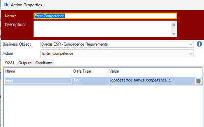

Also the only way I can search for a competence in the ESR system is to hard code in all of the competence  names which are around 47 as I cant pass in a collection field name (in this case the competence name ) into my search action – all I can do is search the position number by using Item Data.Position Number in ESR system and then the only data I have is either y or n  which I cant obviously search for anything with that - so im having to do a decision stage to see if it has y against it – if it does then use the hardcoded competence name to search for it and add it, if it’s a no it moves down and then repeats the decision stage for all 47 competence field names which I think is very messy and must be an easier way.
decision stage
If yes then have to pass in hard coded competence name into enter competence as cant use collection field name
Again any ideas that may make this easier?

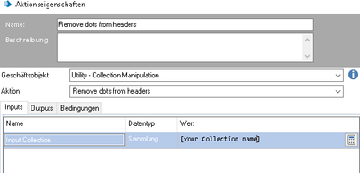

Hi Frankie,
About the dot question, there is in "collection Manipulation" the action "Remove dots from header" (input and output is the same collection).
