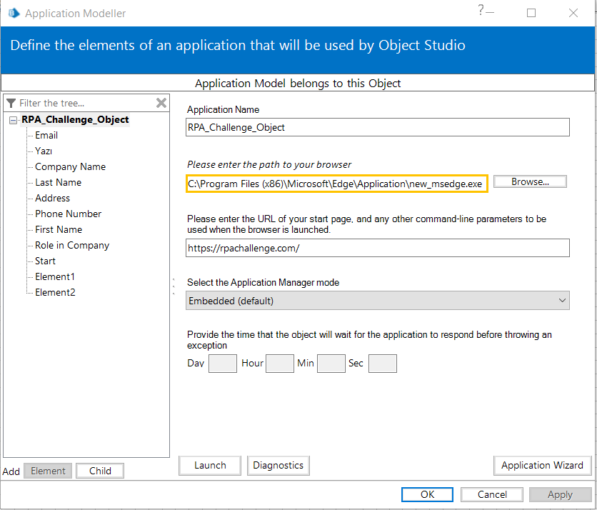

18-01-23 08:23 PM
Hi Rik Kotter,
It is easy.
In the application Modeller, you can set your browser path: C:\Program Files (x86)\Microsoft\Edge\Application\new_msedge.exe
After set the application modeller, every launch action will be in the new browser window.

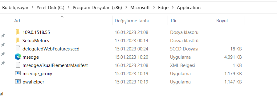

"C:\Program Files (x86)\Microsoft\Edge\Application\" Folder dont have "new_msedge.exe". But it works, you can try this.
Have a nice day...
