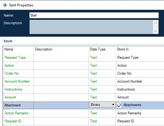

As you mentioned, we are using older approach of exposing each VBO directly as a SOAP web service. Below are the parameters have configured in the Startup parameters of each actions (having around 8 actions) in the VBO and exposed as a SOAP web service. All the actions will get the values for the startup parameters, update it in the collection and add it to Work Queue.
My query is how can we get list of values for each startup parameters and how can we add it to work queue.
For Example: In below snapshot, have setup startup parameters. Once it is invoked, values will be passed to the data items with single value. But our scenario, we will get single value for Request Type, Order No, Action Remarks and for the other parameters we will be getting Multiple Values like Account Number (5 Accounts), Amount (5 Amounts), Instructions (5 Instructions), Attachments (8 Attachments), etc. How can we configure it and add these items to Work Queue. Hope this is Clear.

@Mohammed Nissar Kaja Mydhin,
If you're trying to interrogate the process/VBO to determine what the startup parameters are you'll need to use the HTTP interface exposed by each runtime resource. There's a specific command/endpoint called getparams. You can find more information about the Resource PC commands at the following links:
Resource PC Commands
Resource PC HTTP Interface
