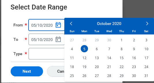

Hi Everyone,
I want to apply leaves by clicking on calendar button and selecting dates. Pls suggest how to do this? I am not able to select.
I was creating the bot by using "navigate". But it gives error that way. Its not working with below bot.

1) please check if the Date field allows writing or pasting of the value.
* But you have to code waits and clicks appropriately to actually open the calendar window in the first place
Hope this helps.
- If it allows, then try Write or Navigate stage (Global send keys) to do it.
- First, check if you can spy elements(dates) within the calendar window.
- But if elements are not recognized within the calendar window,
Hope this helps.

Hello Swati
Which spying methode you used? Which error message you received? Are you able to identified the elements in Application Modeller?
Maybe you have to use another spying methode instead of HTML, check if you can use AA. Do you able to enter the Date into the Date Fields instead to click on the date?

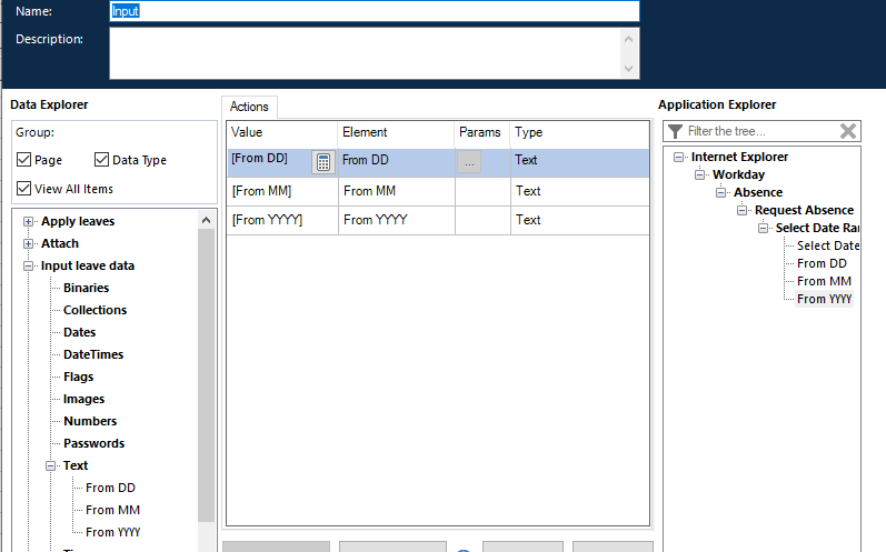

In Application modeller, I used UI Automation method to spy the elements. Now this time I did not open calendar. Instead I spied each and every element (From DD, From MM, From YYYY). I have pasted the screenshot of the elements I spied below. Also pasting the screenshot of bot I created. In the bot, I am calculating current date and trying to write in the "From Date" box in screenshot 1. However, when I write, then it gives me below mentioned error.
Could you please help here.
Swati Agrawal
"Internal : Failed to perform step 1 in Write Stage 'Input' on page 'Input leave data' - Unable to find a valid pattern - required: ValuePattern"

Hi Swati,
The error message indicates "ValuePattern".
I believe you have already tried writing the full date in the required pattern DD/MM/YYYY and it didn't work?
For existing code:
Maybe try inducing some delay and write DD, MM & YYYY in individual Write stages because I am thinking once you enter DD that's when "/" gets activated and similarly, once you enter MM the second "/" gets activated
or
you can do the entire thing in one Navigate stage using Global Send Keys along with Delay as well.
All the best!
