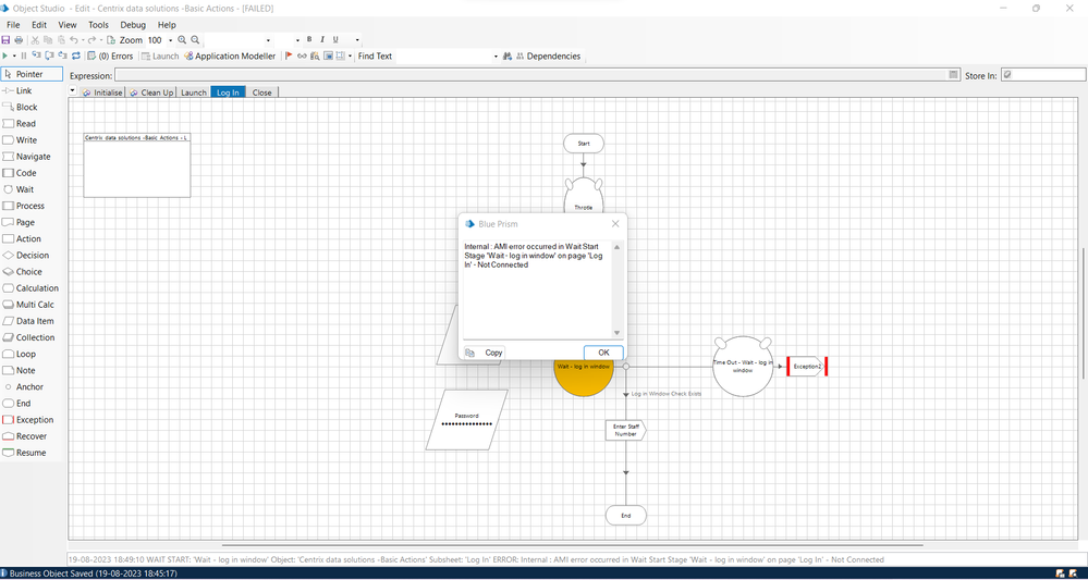

In Write stage i am getting error :-"Internal : AMI error occurred in Wait Start Stage 'Wait - log in window' on page 'Log In' - Not Connected".

Internal : AMI error occurred in Wait Start Stage 'Wait - log in window' on page 'Log In' - Not Connected. Can anyone help me on this issue to resolve. Thank you in advance.

The problem is the same as with the notebook. You must Attach to the application. Check my answer in your previous topic:
Error messages in Notepad while closing. | Blue Prism Product
