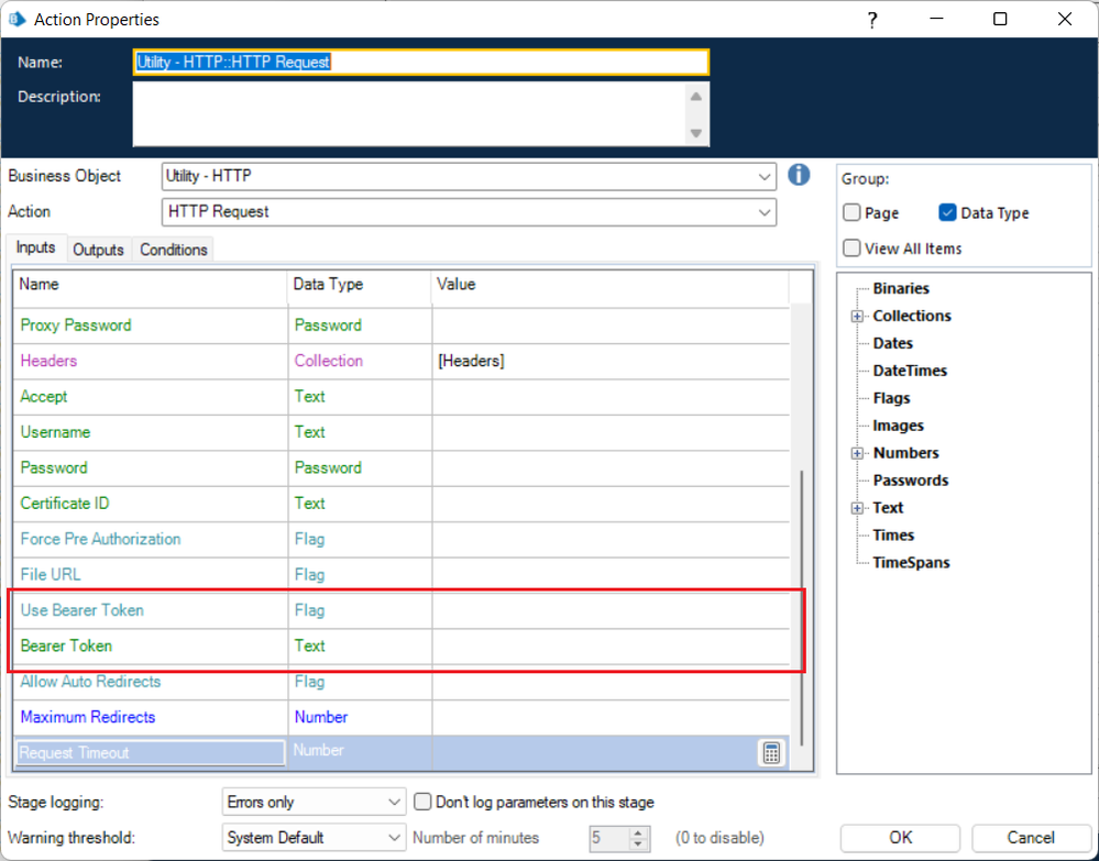

17-11-22 02:39 AM
@vikas kalwala,
So you're using the Utility - HTTP VBO, correct? If so, are you using the latest version from the DX (see the link below)? Can you paste a screenshot of the properties you've set for the action?
https://digitalexchange.blueprism.com/dx/entry/3439/solution/utility---http

17-11-22 01:15 PM
@vikas kalwala,
So you're using an API key. Does that need to be placed in the Authorization header, and is it considered a Bearer token? If so, you do not want to add it via the Headers collection. Instead, you want to set the User Bearer Token property to True and then place your API key in the Bearer Token property.
