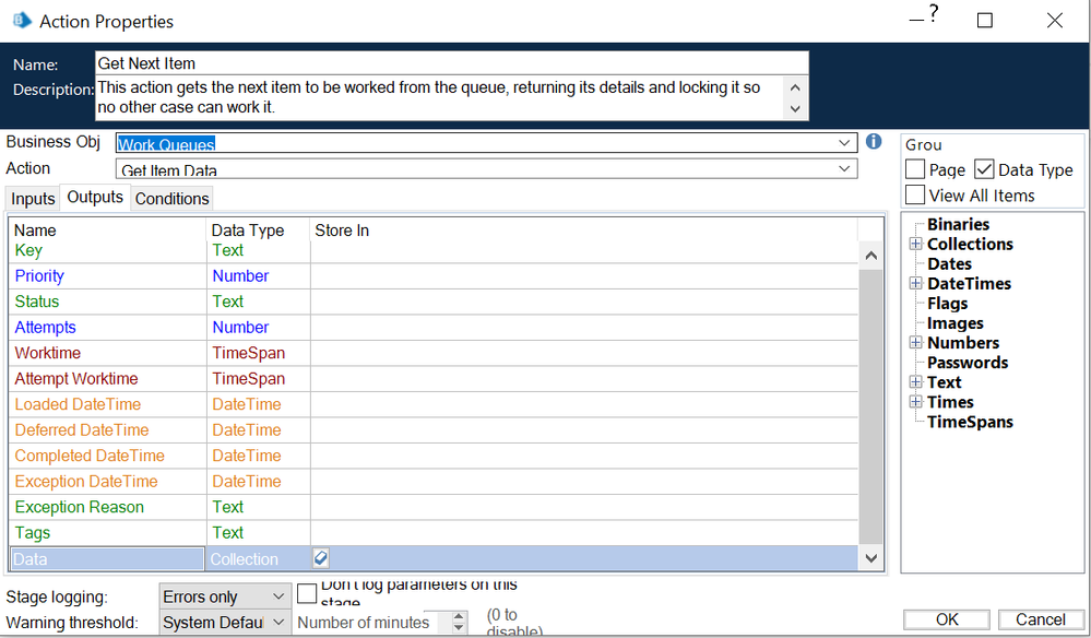

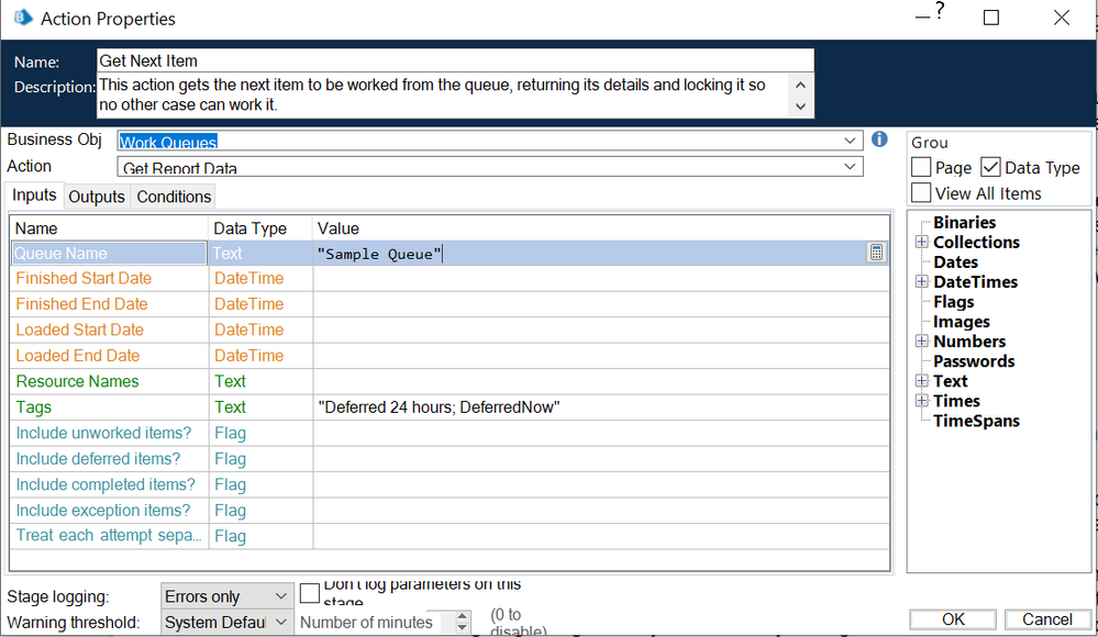

Hi @Manish Rawat : If I understood it correctly let me know, the solution could be as - for Point 1 : For each Items bot goes into some system and checks the status - If those are not completed - Set Tags before deferring something like - "Deferred 24 Hours" or a shortened form "D24H"
Point 2: I am unsure if this process goes back to check the only items which were deferred in point 1 or is it a separate process to find all the items those are not updated irrespective of what was already deferred in point 1 - if its not separate to point 1 and acts on same deferred items in point 1 - it can retrieve the items doing get next item including tags "Deferred 24 Hours" - Change Tags to DeferredNow and Defer it to Now().
Point 3: If the updates has not happened in 24 hours - and it needs a cumulative report including everything - you can do Get report and collect all the item IDs by mentioning Tags you did set on these items in the queue :
Get Report Data :
Loop Item IDs from Get Report Data Output: and call Get Item Data - you can play around doing collection Manipulation to create it to a Data Collection with necessary outputs retrieved from get Item data:
Mukesh Kumar

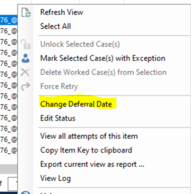

Hi @ewilson ,
Is it possible to achieve the Change Deferral Date functionality programmatically, as done from the control room UI manually shown below:

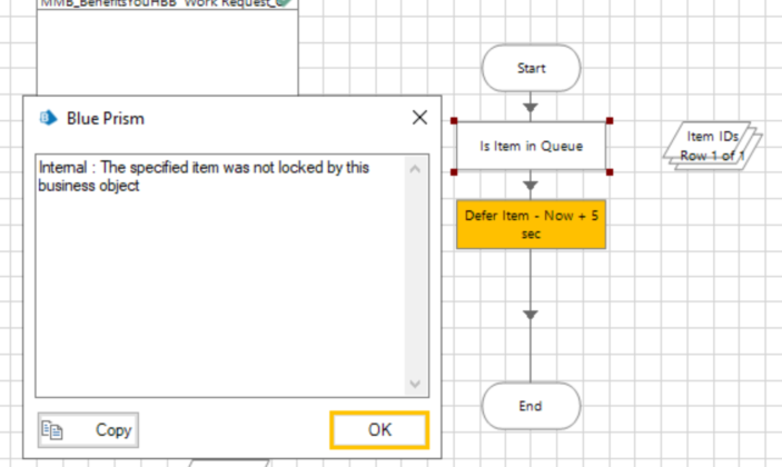

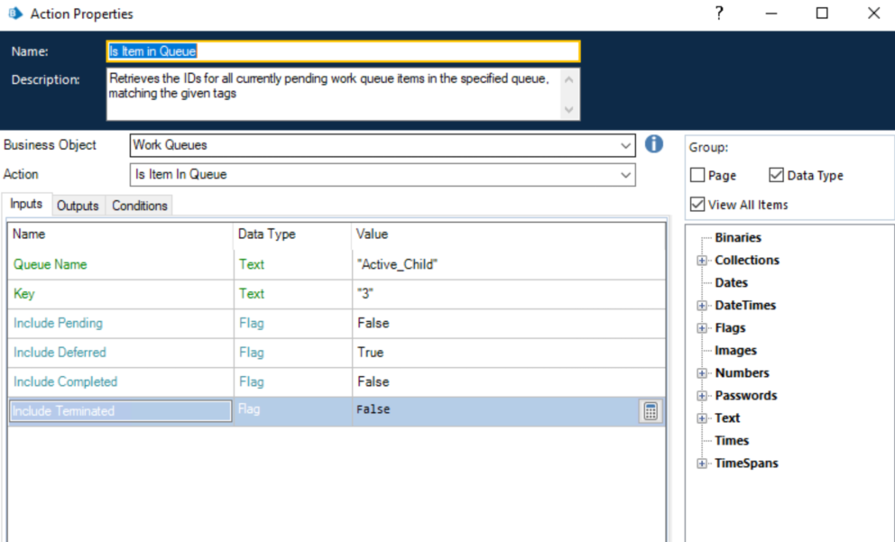

Hi @Jeffrey McCormick ,
Can you help me with the process steps to do so,
When I try to use the below steps:
1. Get Deferred Item in Queue using Is Item in Queue action:
And then Try to Defer it for next 5 sec:
When I run the second action this is the error that I get from BP:

My assumption is that you will need to add a 'Get Item Data', 'Get Item By ID' or similar action once you know the item you want to update from the Work Queues BO in order for the resource to first lock the workitem so you will be allowed to update it.

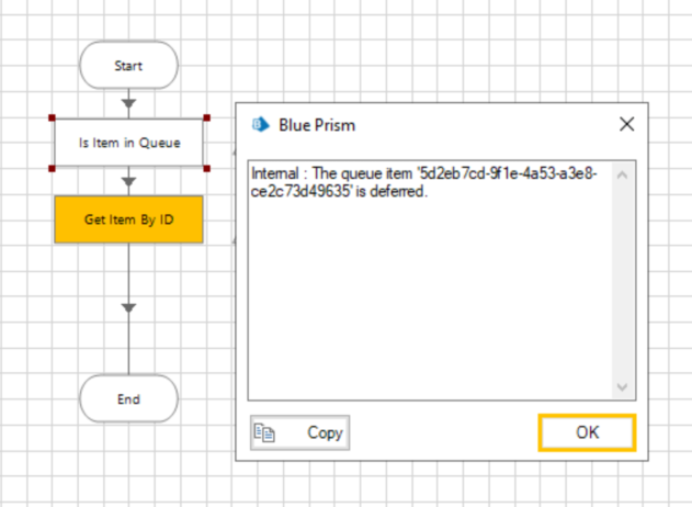

We do have the Item ID but Get Item BY ID won't work for locking the Item unless the defer time for the Item is passed.
So scenario:
8:00 AM - Item 1 is Deferred till 11:00 AM
9:00 AM - We identified that Item 1 has been updated in the application, so we want to get this item before 11:00 AM and update it.
But we can't do it even when we have it's Item ID, because Get Item by ID is giving the below response:
Manish Rawat
