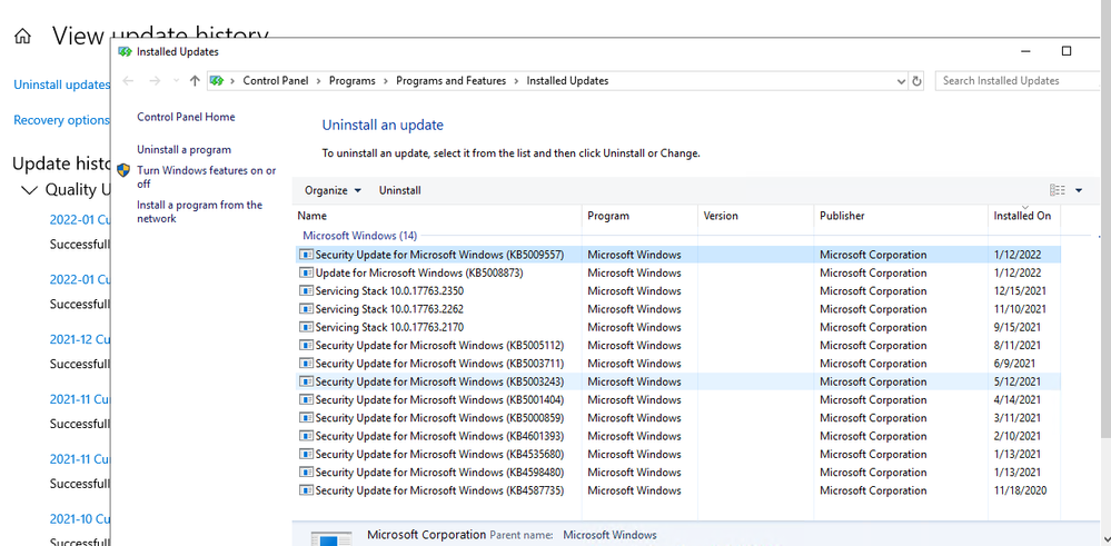

Hi @Diane Sanzone
Thanks for providing information and link.
As per my screenshot do you think I can uninstall KB5009557 which is recently updated patch on 12 Jan. Any suggestion here?
As per the article in above mentioned link, we need to seek IT team assistance which is difficult in my scenario(in my case Prod Env should be taken care by us, IT team will not interfere here). And first we need to check in non-prod Env where at present we are not facing the issue. so it might not help here.
Pls share your experience once you have fixed issue permanently using the article.

I'm sorry. I don't know for sure either way. All I can do is tell you we uninstalled both patches from that date and we were fine afterward.  That said, it seems to me that the fix from BP is a lot less time consuming and will be a permanent fix.  If you don't apply it now, when you install the February patches from Microsoft you'll likely be in the same boat (they're cumulative updates so I think each month includes all the stuff prior unless it's superseded).
After we test the BP fix in our environment I'll post the results. Hopefully that will help you.
Diane Sanzone
