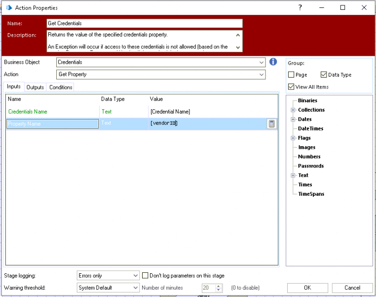

Thanks Manish, much appreciated.

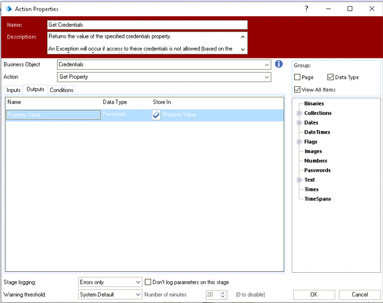

Inputs:
Output:

Hi Gavin,
you are using it correctly, I don't see anything wrong there. Just make sure the [venderID] having the actually "Vender ID" you are searching credential for.
I mean it is dynamic and having correct "ID" in it, when you are calling "Get Property" action.
e.g. if you are using a loop for fetching [venderID], "Get Property" action should be within the same loop.
