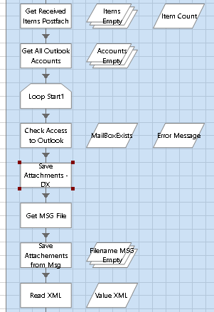

I found a solution as a workaround by chance, which now lets me get to the target files.
For you for information: I tried the Outlook VBO module from the DX again to verify whether the same result comes here with regard to the code, etc. It works over this, even with the positive side effect that the EML directly as MSG is saved. The DX function "Save Attachments from msg" can then also be used for this 😊

Hi Björn Reinke
Could you please help me with how did you convert the .eml file .msg file as outlook vbo is only able to read .msg file.
I have similar requirement to read contents from .eml file. So could you please help me on this.

Hi Divas,
as described above, I only used the Outlook module from the DX to be able to save the attachments directly as a msg - this file can then be edited again normally...13422.pngBest regards, Björn

@divas gupta,
As @Björn Reinke points out, please make sure you've downloaded the latest Outlook VBO from the DX.
