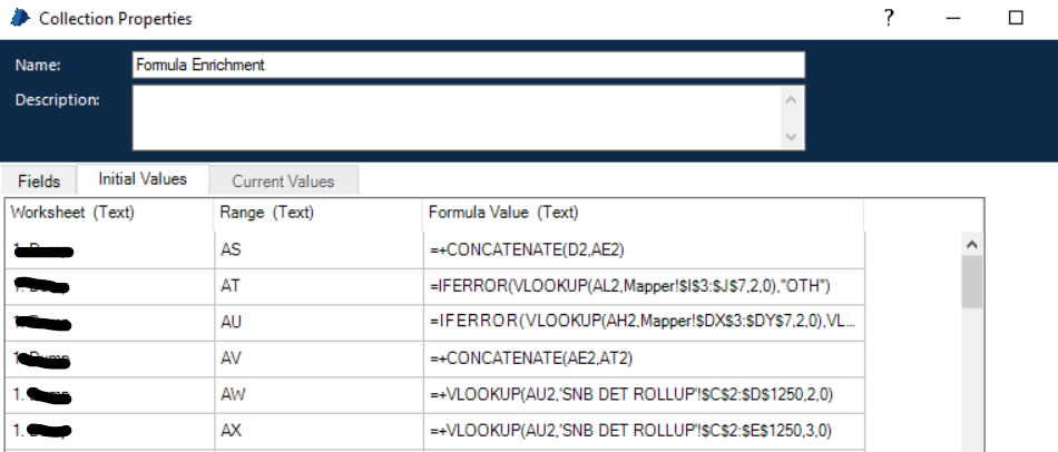

Hi Neermal,
We deal with very large excel formulas, we simply add the formula to a collection. Then use the Coll.Formula in the "Set cell value" stage. It works.

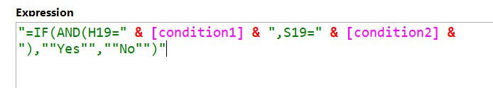

Hi @Uriel Lander,
I am assuming that you are facing issues while trying to do "Set Cell Value" and trying to write the formula. It seems there is a syntax error of AND condition. Please refer the below sample:
I have used Yes and No as output depending on the condition matching with H19 and S19 cells.
