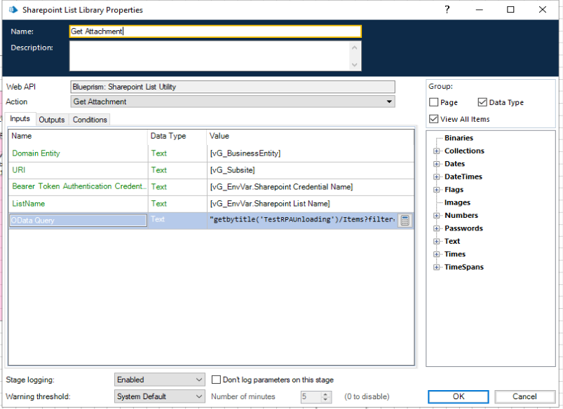

Hi All,
I am trying to use the Get Attachment action from the Sharepoint API service but it is not returning any data. The attachments would be image files (.tiff). I am not sure how to form the OData query. Could someone help in this regard if you have already used this action?

Hi Eric,
I am using the Sharepoint Skill - Sharepoint List Utility, which has an action - Get Attachment.

@Geetanjali Vajrapu,
Try setting the OData Query input parameter to $expand=Attachments
07-06-22 03:09 PM
Hi Eric,
Below is the OData query that is being used:
"getbytitle('TestRPAUnloading')/Items?$expand=Attachments"

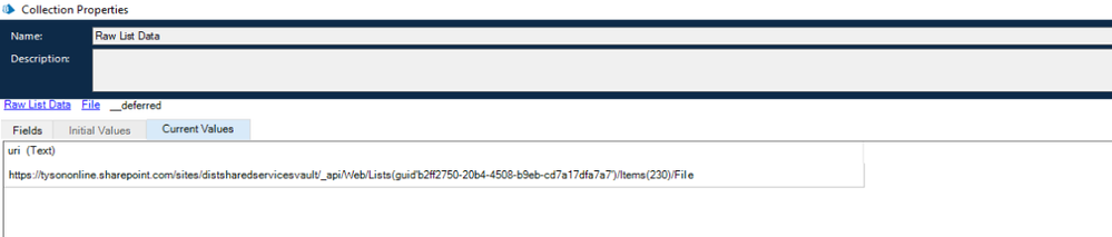

07-06-22 04:18 PM
Hi Eric,
I tried using the below queries:
"$expand=Attachments" - This gives me the below error
But when I use the below OData query, I do not get any error, but neither getting any output data as well.
"$expand=AttachmentFiles"
Below is the list of fields that I am getting from the Sharepoint List.
Any help would be really appreciated!

07-06-22 06:33 PM
In your first screenshot of results from SharePoint lists it looks like there's a column there titled File (Collection) and each row has a value of Row 1 of 1. If you click that, what content do you see in the embedded collection?

08-06-22 08:25 AM
Hi Eric,
There is a URI in the embedded collection.
