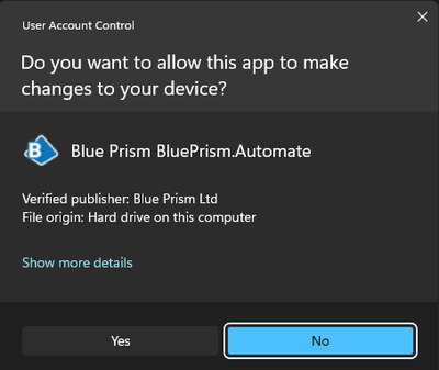

I'm not sure about simply checking the box to run the exe as administrator. Maybe that would work, but I would expect a UAC popup to occur unless you've adjusted the security settings on the machine, which I wouldn't suggest doing. If that works, then that is the simplest way to handle it for sure.
However, for us, we get this UAC popup:
The way I've handled this is in a few steps. I proofed this out, and it does work, but we never actually put the automation into Production that requires this.
Step 1: I had a batch script in the All Users startup folder that would check to see who the logged in user was. If it was the specific user for whom we wanted to launch Blue Prism as admin, then it would call a specific shortcut file (a .lnk file), described in Step 2.
Step 2: That shortcut file was designed to trigger a task in Task Scheduler on that machine, described in Step 3.
Step 3: The task in Task Scheduler was created with the details such that the specific/same user as we detected in the startup file will launch automate.exe as admin. Also configured in this were the details for the specific dbconname and port number etc and what not for running a Runtime Resource.
I know this sounds a bit convoluted, but it does work, and the reason was so that we were not circumventing any security protocols or changing any security settings on the machine, and it also only would do this for a specific user that logs in.
You could of course do this a bit easier if you expect all users to run Blue Prism in admin mode, but we prefer to not do that.
Just a reminder, try Harish's suggestion first since it is much simpler. I just expect you'll encounter the same issue I described above. Your option I think is then to either do what I suggested or change the machine's security settings, if you have approval/access to do so.
