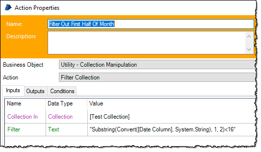

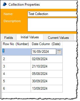

Because you, from your examples, have zero padding in your date format it is fairly easy to apply a filter to pull out the rows you want.
You just have to create a filter string that:
"Substring(Convert([Date Column], System.String), 1, 2)<16"
27-09-24 02:08 AM
