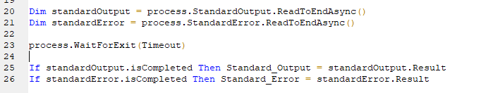

Hi Dominika - have you tried using a bigger timeout value? Line 25 of the code stage shows that the output will not be generated when isCompleted is false, which makes me wonder if sometimes the timeout has elapsed before the command has finished.
Hello John, thank you for clearing this out!
Value I use is "-1" which should wait indefinitely.
