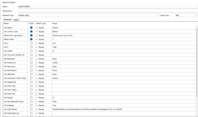

yes, that got it to work and I have now ran the process several times since it recognises it however when I run the process in control room it does not recognise the element in the application modeller and terminates.
Please check with below steps,
1. As the run speed through control room will slightly be faster than that in debug mode so I would suggest you to add a wait stage before clicking the download button.
2. As shown in below example uncheck Attributes for which the value is blank.
3. Make sure Match Index attribute is checked.

I have added a wait stage before clicking the download button and checked all the attributes like above and it worked for 5 times in the control room - I then relaunched blue prism and tried it again and the same error occurred :
ERROR: Internal : Failed to perform step 1 in Navigate Stage 'Click Export' on page 'Navigating Rigour' - No element matched the query terms
I then went back into the object and application modeller and it did not recognise the element anymore.

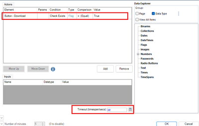

This may happen because of slow loading of application, please add a dynamic wait of 60 seconds before clicking the button so that the element is loaded successfully.

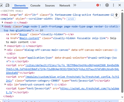

Hi @rebeccabowe
As @faheemsd  said
For example your svg is maybe a child of a div element and maybe if we tell blue prism via xpath to click on that div (or others elements) it will work
Please share with us your html code (do inspect) and then we can help you
