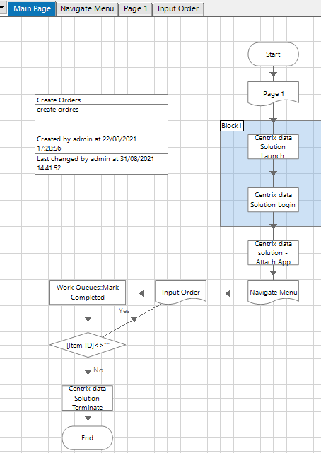

I believe the Get Next Item Action should be before your Centrix launch and navigate logic.
The high-level flow you process Main Page should follow is :
Open Excel and grab info >> Populate that info into the BP queue >> Grab the queue item info using Get Next Item >> Centrix Logic >> Mark Exception/Completed

I modified my main page as you suggest:
But I have the error on my "New Order" Object studio.

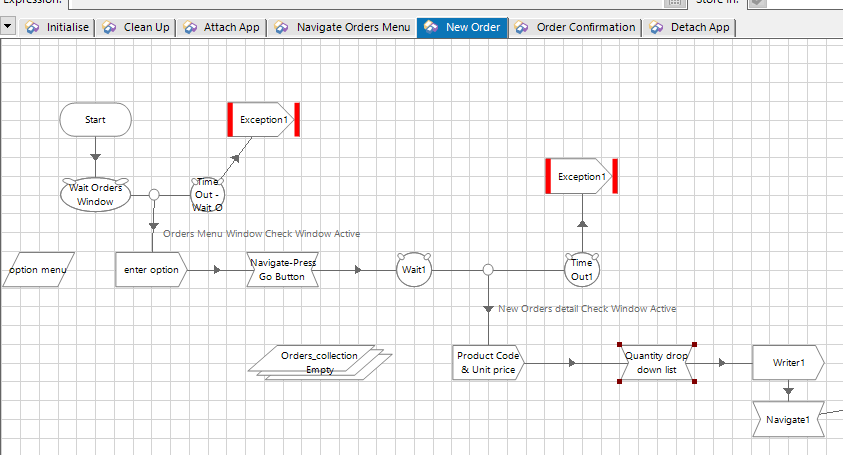

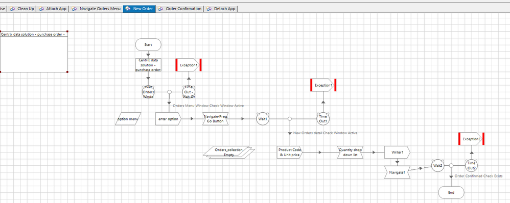

This is how I made product and price...but clearly it's not correct..
If you have any idea, it would be highly appreciated.

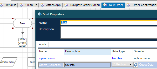

To pass data to a VBO so that it can write into the application, we must create input parameters in the Start stage. Once this is done, when an Action stage is added to the process, you can see the parameters required by the VBO.

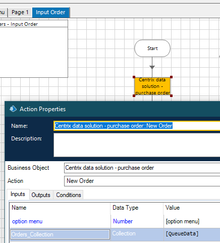

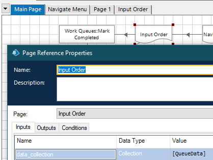

Then I pass it to Input order in the main page:

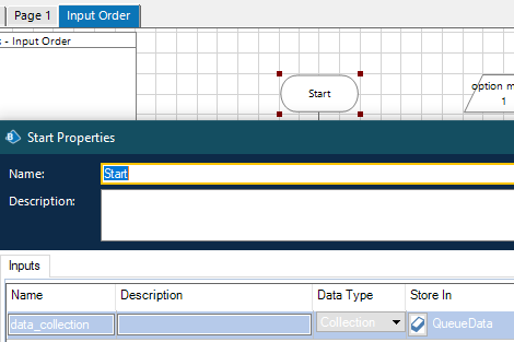

Then to the start properties of Input Order
Then as an input in the Action properties:
Then as input in BO/new order

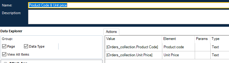

Then in Write stage:
Do you know what I am missing?
Thanks!
In the VBO start stage, try using individual parameters, like Product Code and Unit Price, rather than passing the whole collection.

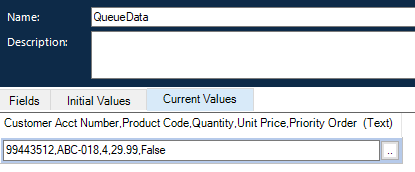

Also, it looks like something has gone wrong at the 'read csv' step because your collection doesn't look right. It should have 5 columns, with each value in a cell. But here you have 1 column with all the values concentrated in the same cell. I think this is the reason for your 'field doesn't exist within this collection' error.

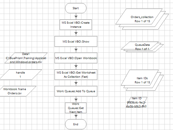

Get Worksheet As Collection (fast) has an output names Orders_collection.
Which seems correct:
Next, the action stage Add to Queue has the following inputs:
Ouptuts:

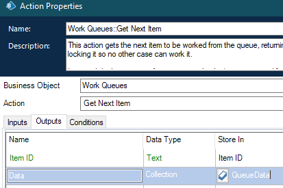

Then, the Get next item, has the following inputs and outputs:
But QueueData register the information as follows:
Thanks a lot!!
