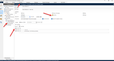

Navigate to system tab in Blue Prism enterprise and create a calendar and update for the next 1 or 2 years specifying which dates scheduler need to be excluded

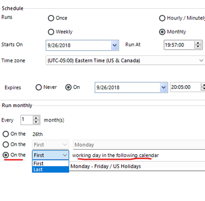

I don't think it is possible to achieve what you're describing purely from Scheduler functionality. The problem is that Scheduler only provides the ability to run on the first or last working day of a week/month OR on a specific # day of a month or a named day of a week, that kind of thing. What you're looking for is like this part of Scheduler's "Run monthly...On the First/Last working day in the following calendar", but it only allows for more First/Last as options, and you need Fourth and Tenth.

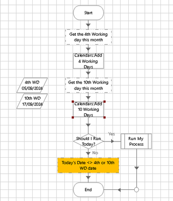

As Dave mentioned, you can add logic to the start of your process to check if Today's date = 4th or 10th Calendar date.
This will mean that the schedule you create will need to run it every working day, but it's a small price to pay if you cannot/don't want to code this.
It would be something like the below:
