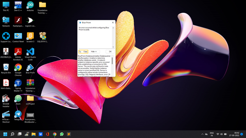

yes i was installing bp learning edition but also its showing error.
An error occurred whilst configuring Blue Prism localdb.
Error:
BluePrism.DatabaseInstaller.DatabaseInstallerException: Unable to determine whether database exists - A network-related or instance-specific error occurred while establishing a connection to SQL Server. The server was not found or was not accessible. Verify that the instance name is correct and that SQL Server is configured to allow remote connections. (provider: SQL Network Interfaces, error: 50 - Local Database Runtime error occurred. Error occurred during LocalDB instance startup: SQL Server process failed to start.
at BluePrism.DatabaseInstaller.Installer.CheckDatabaseExists()
at BluePrism.AutomateAppCore.LocalDatabaseInstaller.get_DatabaseExists()
at BluePrism.AutomateAppCore.LocalDatabaseInstaller.get_UpgradeOnly()
at AutomateUI.BPApplication.Start(String[] args)

Hi @Roshan Kumar,
The blue prism is trying to make connection with SQL server but it is not able to identify the same. Can you please try installing SQL Server which should resolve the issue

Satish1414
Hi Roshan ,
As per the error logs it seems the Database instance you are trying to enable was not accessible from your current environment . Can you check the DB server is accessible from you current environment(where you are trying to install Blue Prism) and try again .

i am not able to identify what mistake I am making in installing the SQL server as its also creates problems in installing SQL server
Have done the installation of ssms but again the same problem exixts.
