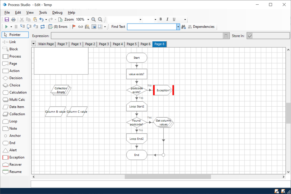

Hi
There are a couple of options here to do this, if you want to use a collection to just return the other 2 column values if the post code value exists then you can do this using a loop. Continue using the action Utility - Collection Manipulation -> Collection Contains Value to determine the post code already exists if it doesn't then mark it as an exception or whatever you need to do there. If the value does exist the do a loop through the collection using a decision to determine when you have found the value in the collection InStr([Collection.Postcode], [Postcode])>0 when the decision is true then you just need to get the values from the current row and you can do that with a calculation stage to 2 data items for the calulcation you just need to set the collection and column and set the data item to be saved to e.g. [Collection.SecondColumn] or [Collection.ThirdColumn].
The other option is to use excel to find the value then find the corresponding cell values but for this you will need to create a code stage to find the address of the postcode value and then a calculation stage to modify the cell address to include the column e.g. "B"&Mid([CellAddress],2,10000). I've included the code for this type of search below if you wanted to use it. Hope this helps 🙂

vielen, vielen lieben Dank für die schnelle Antwort! Es hat sehr geholfen. Jetzt hat es funktioniert und ich kann den Rest fertig machen. Wieder was neues gelernt. 😉
