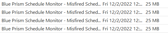

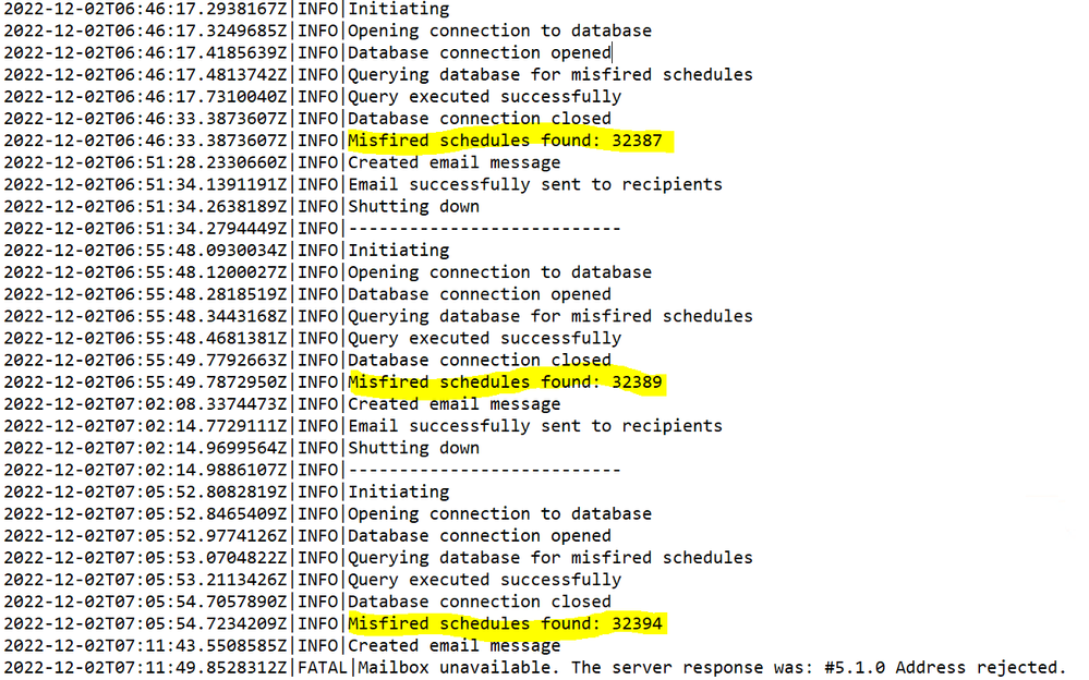

Looks like we are greeting all the missed/misfired schedules stored in the Database, is it possible for us to get the missed/misfired schedules based on the given dates or for the recent week/day else every time we are getting the complete logs in the mail from the Database which in our case is 25 MB every time in each mail.

The first run of the Schedule Monitor will send a complete history of failed schedules. Then it should be incremental so that only newly failed schedules will be sent in subsequent emails. You should not be getting a complete history every time the Schedule Monitor runs. And you should not be getting emails at all (after the first one) unless there is a newly failed schedule.
<KC> We are receiving complete output every time when the Schedule Monitor triggers, and it doesn't look like incremental in our case. Yes, there are new failed schedule before the next trigger (this means, we will be receiving complete output every time (please clarify).
Do you have the Schedule Monitor and Blue Prism database installed on different computers? And are those computers set to different time zones?
<KC> We are using Azure SQL Managed Database and both DB / Blue Prism are in the same time zone (CET).

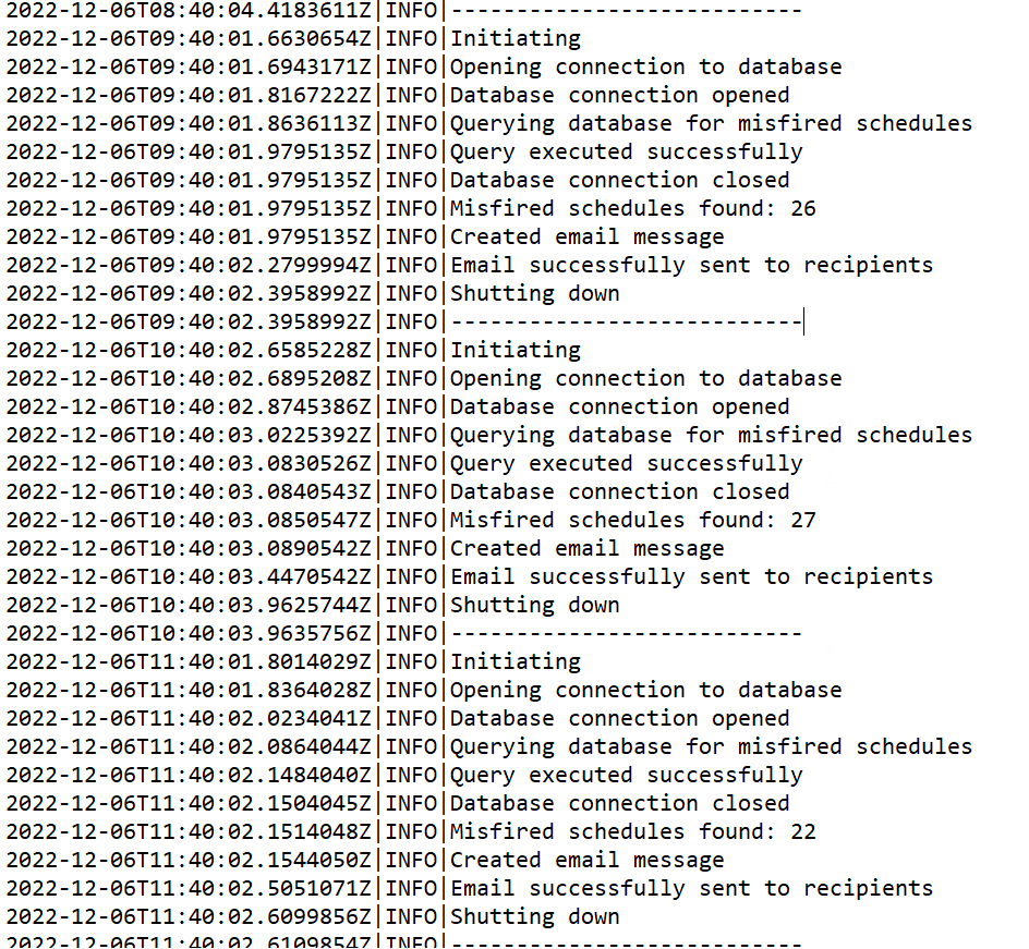

Hi @Charlie Kovacs
Application is working as expected.
We observed that 5 mins trigger on the application is providing us the complete hence updated the trigger frequency to 1 hour, which is now providing us the missing/misfire schedule only from the past runs (PFA)
If you could check and accommodate the below in the new version which would be more helpful.
              * Segregating missing schedules & misfire schedules in separate emails.
