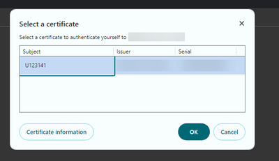

I have this issue, that when i open my desired website on Chrome i have to select the certificate. The problem is I can't spy that popup with Browser mode. Is there any known work around for this PopUp?

Did you get chance to try UIA mode? If the UIA mode is not available try to append "--force-renderer-accessibility " at the end of the URL While launching an application and try and see whether UIA mode is available.

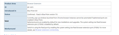

Also check the browser extension port based on the Version you are currently in
https://support.blueprism.com/en/support/solutions/articles/7000076810
https://support.blueprism.com/en/support/solutions/articles/7000078225-why-does-uia-spy-mode-work-in-edge-but-not-chrome-
https://support.blueprism.com/en/support/solutions/articles/7000079599--bpe-bp-1673-pop-up-windows-launched-from-chrome-browser-instances-cannot-be-automated-if-ephemera

NicolasSahli
Thank you! This worked out! I was able to open chrome like you said and then with the keystroke "Enter" to click the Ok button in the PopUp!
