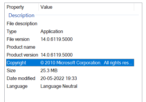

This error usually comes when the correct drivers are not installed on the machine or any version conflict occurs. You can try with Access Database Engine 2010 installation file from here: Microsoft Access Database Engine
I am also using M365 and was able to resolve this issue when I was getting the same error. The version Access Database Engine 2010 seems to work for me but not 2016 for some reason:
WonderBotz India Pvt. Ltd.
