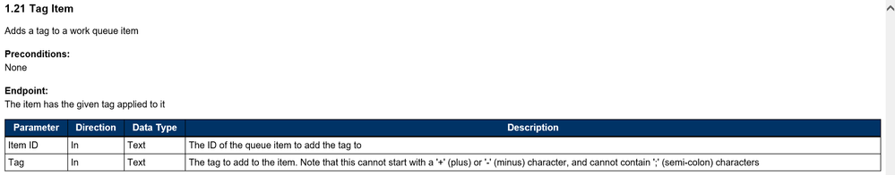

Is it possible to add multiple tags to a queue item at once?
This is where the item has been picked up to be worked not when adding it to the queue.
There can be instances where we want to add a few tags onto an item but just seems a bit over the top to have to add multiple tag item actions.
The Tag item action doesn't allow for semi-colons so doesn't feel like this is possible.

Apparently is not possible to add multiple tags at once with the "tag item" action. The only way to do it is when you add the item to a queue. Here a previous thread explaining the topic.

 There is a limitation  but you can try using space or other special character as a delimiter but there are disadvantage it cannot give the same capability of existing tag
Below screenshot from the Action information panel it indicates tag should not contains semi colon
