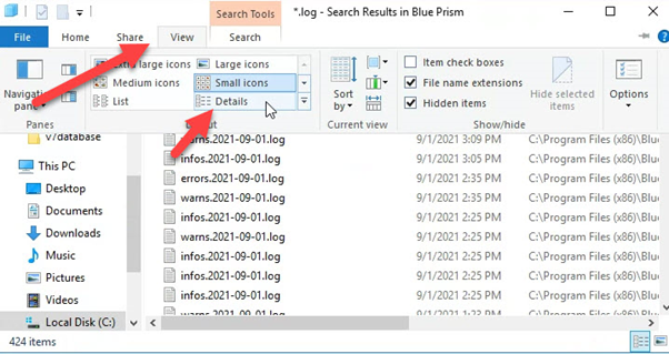

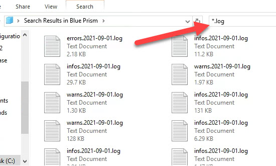

One solution is to navigate to the 'C:\Program Files (x86)\Blue Prism' directory within Windows Explorer, and do a search for '*.log', as seen here:
You will also want to make sure the view of these results are set to 'Details', and that the search results are ordered by 'Date Modified', as seen below:
When you are ready, reproduce the error you are seeing (for example by refreshing the relevant page of Hub). Once it appears, refresh the search results and you should see the most recently updated log files.
