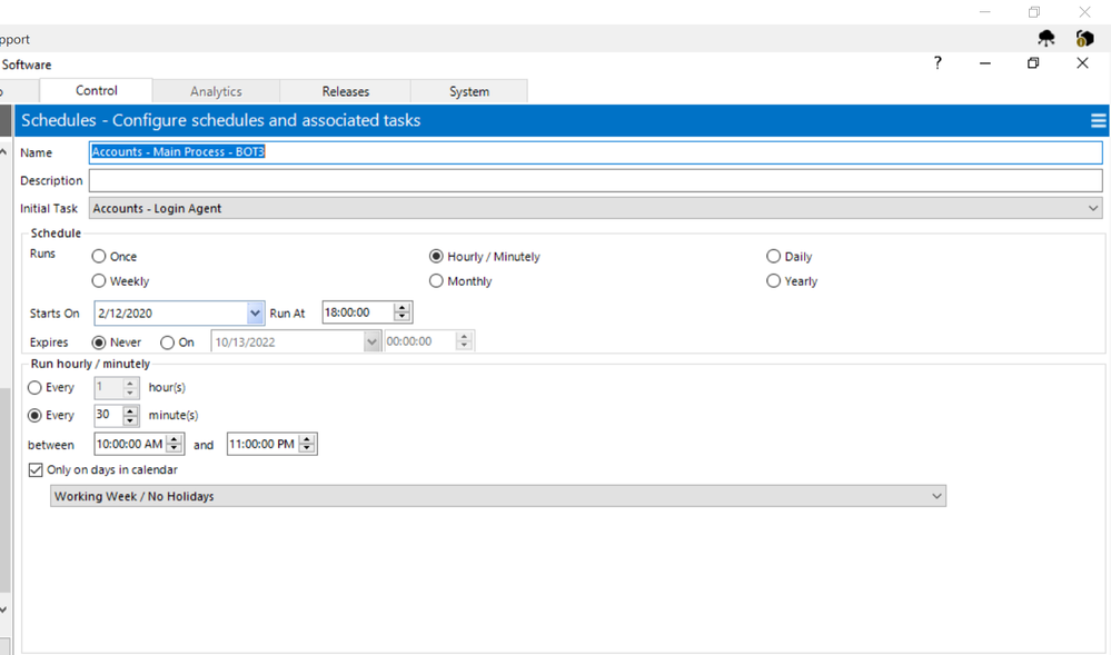

I have a bot that runs around 10.00 am to 6.00 pm to ast time. I have extended the time to end at 11.00 pm. but the bot only runs around and ends at 6.00 pm. When i manually tried to run now on scheduler the bot logins and logout. I have been struggling with this, please help?

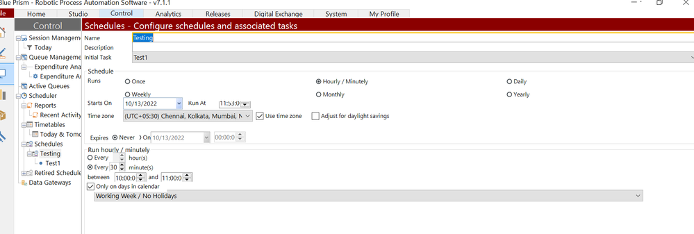

Example -
1. I have created a scheduler that will run every 30 minutes.
34887.png2. Click on Timetables to see planned schedules.
--> As per the screenshot attached by you, the Initial task is Accounts- Login Agent. You need to go to the left-hand side and expand Accounts - Main Process schedule and select Accounts - LoginAgent task. After selecting the task, just validate the next tasks to be performed in "On Complete" and "On Exception". There may be chances that after performing login the initial task, you might be running the logout task.
