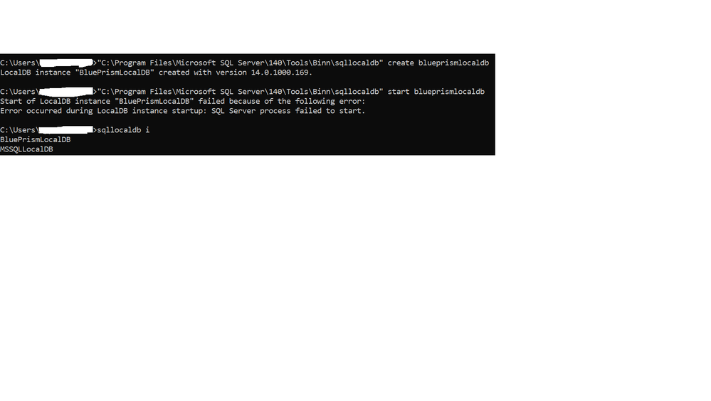

 Just after I set Admin Credentials. I get following error
There was no previous of instance of sql present  and MS Sql 2017 localDB is installed in pc
I have created db using above instructions in link
